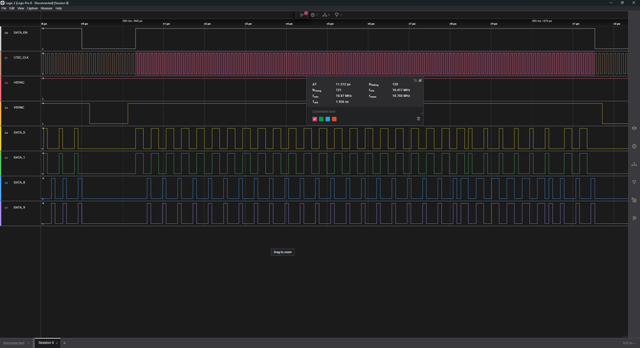

I use STM32F429IGT6 MCU I am trying to communicate with TI's DLPC through HW connection.
To use this, use LTDC.
SW uses the Standard Peripheral Library and Complier uses IAR.
The HW GPIO settings were set using CubeIDE, and were set as follows according to the IDE's GPIO settings.
I am trying to send a 24bit image by setting it to RGB888.
1. When sending as RGB888, the settings are as follows. Is this the correct format?

2. When sending data as shown below, Logic Analyzer seems to display something strange.
static const uint32_t RGB888_120x100[9000]
for(int i = 0; i<9000; i+=4)
RGB888_120x100[i] = 0x0f00000f; // B 0000 1111 G 0000 0000 R 0000 0000 B 0000 1111
RGB888_120x100[i+1] = 0x00000f00; // G 0000 0000 R 0000 0000 B 0000 1111 G 0000 0000
RGB888_120x100[i+2] = 0x000f0000; // R 0000 0000 B 0000 1111 G 0000 0000 R 0000 0000
3. There is no problem when data is not being sent, but when data is sent, the TIMER system dies.
