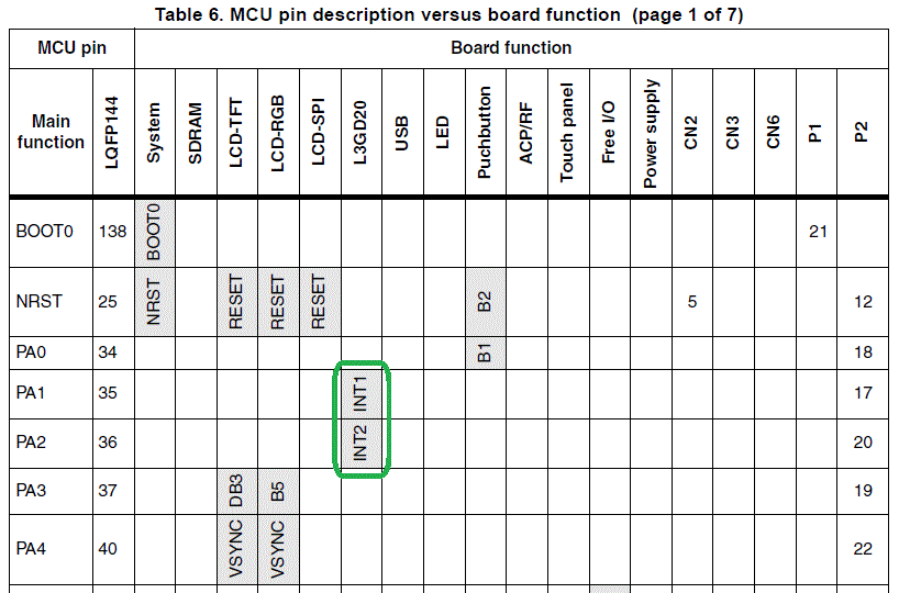

Unless you've addressed them, there are a number of physical pin conflicts on the STM32F429I-DISCO

I have created little test app for TIM5. Channel 1 and 4 are working, Channelse 2 and 3 not. Source code:

2014-06-17 5:04 PM
Isn't there just a pin conflict you aren't dealing with?
