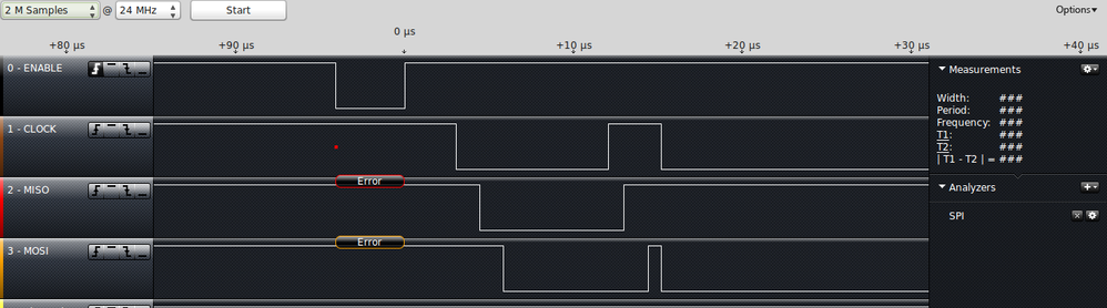

Hi, I just received my STM32F429 discovery board and I tried to implement basic SPI but I'm stumped as to why the logic analyzer output was different. Can anybody point out were I was wrong. Here is the code.

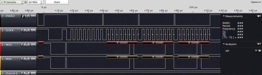

And here is the output of the logic analyzer.

2014-01-12 8:20 AM
Thank you very much clive1! So now I properly configured the select pin. But I now got the following result from the logic analyzer...it seems the values that are sent are being doubled. What have I done wrong now?
2014-01-12 9:23 AM
Perhaps because the analyzer chooses to use the falling edge of the clock, and not the rising edge?
2014-01-12 3:02 PM
I think the logic analyzer trigger as first clock pulse the 'glitch' generated between GPIO_Init() and GPIOA_Config() so the data are shifted left by 1 bit.
Try to set all used GPIO pins to 1 before to call GPIO_Init() either in csInit() and spi1Init() using GPIO_Setbits() or GPIO_Write() so when you initialize the port in output mode, the respective bits in ODR are already set.2014-01-18 7:27 AM
Hello
a.rocchegiani! I did what you suggested and still got the same output.
