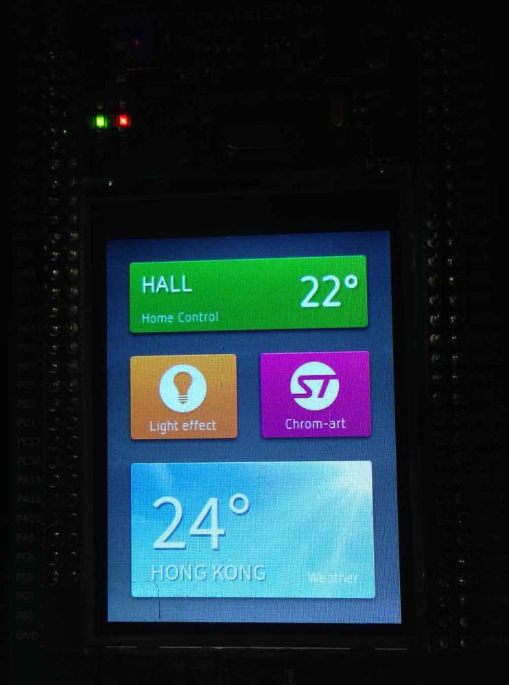

Hello all. I have a discovery board with the 2.4'' LCD.

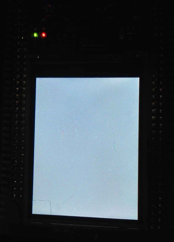

When i download any example with GUI in all situations and wait some time the screen goes white. Does anyone knows why and if the board is defective.Thanks.2014-10-22 10:13 PM
The board was defective. Confirmed by the seller. I ordered another board from other manufacturer and wasn't displaying in white.
The seller returned to me the amount invested by the total of the board. They argue that some units were bad.RA2014-10-22 10:27 PM
Some of the panels are not well attached, and this is exacerbated by shipping. Pressing the top edge of the screen can help.
