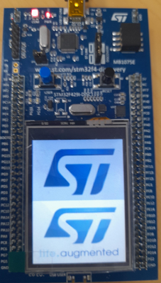

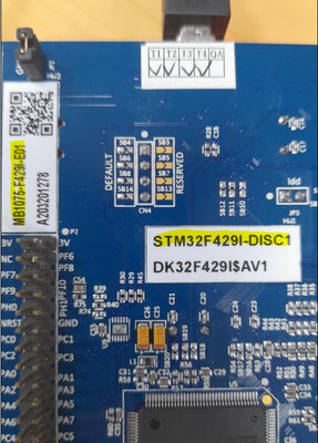

Hello @jake11212 ,
I tested the BSP and the LTDC_Display_2Layers examples with STM32F429I_DISC1 REV-E01 and I'm able to run these examples without issue as shown in the below figure:
May be your LCD is damaged.
Do you get "Error_Handler();" in HAL_LTDC_Init?
Thank you.
Kaouthar

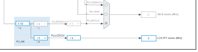

Hi Jake,
I've just had exactly the same issue. I believe the issue is a change in the default clock settings produced by STM32CubeIDE. Try with the above and it should sort it out.
