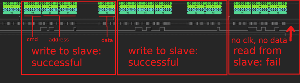

Hi and thanks for responding!
Yes, polled communication works 100%.
When using DMA, writing to the device works as expected. When reading from the slave, only the first part of the "transaction" works - when the master sends the read command and the register to read from. But the following spi read to actually receive the data does not happen.
As suggested, I hooked up a logic analyzer and decoded (part of) the SPI stream. You can see in the screenshot - every red frame is one SPI transaction. Every transaction consists of 2 SPI operations. Writing to the slave is 2 SPI writes (one command+address, followed by one with data). Reading from the slave is 1 SPI write (command+address) followed by 1 SPI read (receiving the data). The first 2 frames can be seen to be successful, while the last frame fails after the SPI write cmd+address. Because I don't see any waveform on the SCK pin after the end of the write, I expect the error is in my code, since polling works and the slave responds as expected.
If you have a look in my code above, the functions ADE7880_Read and ADE7880_Write each implement a full SPI transaction - first DMA transfer is set up and started to write the command+address, then the code waits for the semaphore, then the second DMA transfer follows, and lastly the code waits for the corresponding semaphore before the CS is set high.
But I have no idea where my error is - did I forget to clear a flag? Did I set up the DMA incorrectly? I can't see it :loudly_crying_face:
Thank you for any further suggestions!
