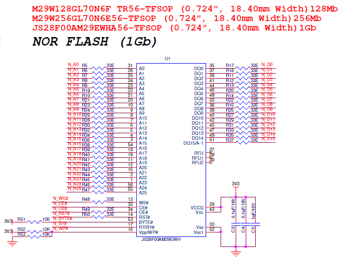

Have you thoroughly reviewed the schematic design?
One remark for debugging: parallel memories can be easily 'bit-banged', ie. the protocol can be easily tested by 'manually' manipulating the address/data/control lines, with pins set as GPIO inputs/outputs as appropriate, rather than AF.
This can be done from the debugger, without a single line of code.

Hi Clive,
When I read the device and manufacturer id, I get both as 0x90 which is not the right value. Data and address lines are configured properly as per the schematic. Please find below schematics.

Hi JW,
I am not getting how to proceed. Could you please elaborate on the method you mentioned in your reply.

2017-07-19 7:33 AM
Instead of setting up the FMC and the pins for FMC, simply set all the pins connected to the memory as GPIO inputs or outputs, and manipulate them 'manually'.
This is just a way to find out whether all the connections are OK, without the risk of the FMC being misconfigured.
