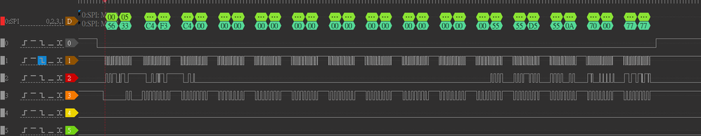

I use SPI with DMA , but the MOSI will shift randomly.

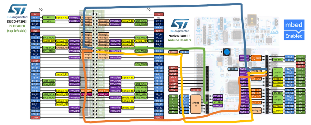

Connection of two boards.

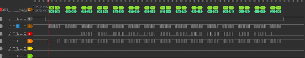

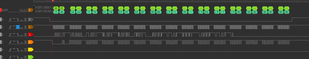

}Random capture by logic analyzer
I try the setting in Slave by change the configuration hard chip select and soft chip select, and the situation is the same.
2019-10-17 2:30 AM
> GPIO_InitStruct.GPIO_Speed = GPIO_Speed_100MHz;
Use lower OSPEEDR setting, shorter interconnection, twist the SCK with a ground wire.
2019-10-20 2:05 AM
I try to twist the SCK with a ground wire, it can success communication in soft chip select.
But when I change the setting the MISO also shift in hard chip select.
2019-10-21 7:10 AM
