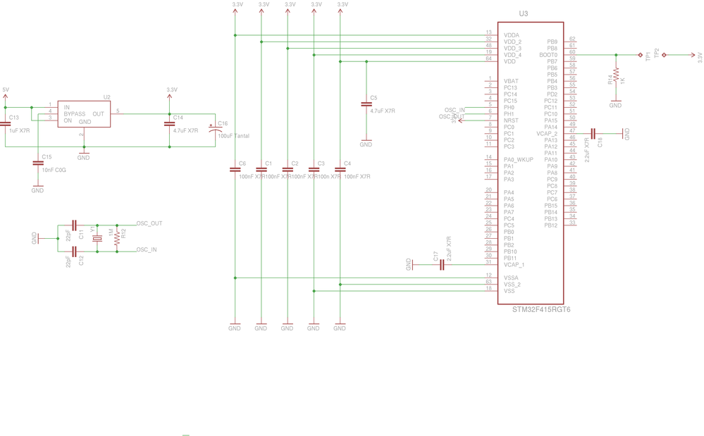

I am engineering new PCB. It is little bit unclear from datasheet so I would like to know if my power supply scheme is correct, especially decoupling capacitors.Thank you very much!2014-12-25 3:45 PM
Definitely don't want to be tying NRST to the 3V3 supply.

Thank you, so I can leave it unconnected?
Also do I need to connect VDDA, VSSA in case I don't plan to use Analog peripherals?2014-12-26 9:05 AM
VDDA also powers the PLL clock multiplier, so it still has to be present even if you don't use the ADC. I always run a ferrite bead between it and VDD, a choke for high frequency switching noise.
