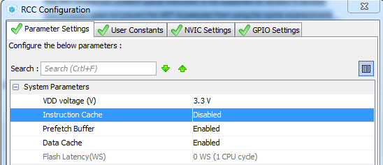

in your first project we use a STM32F415ZGT without any problems. Then we switch to the smaller version STM32F415RGT in a new design. With the same source code we got some times a hard fault when die MCU is booting up.
After two or three days of software and hardware bug finding and trying different versions of CubeMX and F4 firmware we find a solution to disable the Instruction Cache in CubeMX:After that your simple LED blink code runs fine without any hard fault.

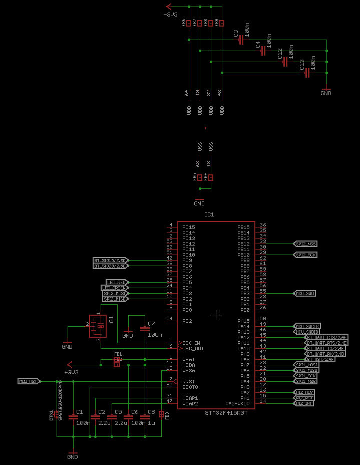

This is your shematic:
The FBx parts are ferrit beads for decoupling, type: TDK MMZ2012R601AT000.
I will check VCAP, PWR_CR:VOS and post.2018-01-08 8:53 AM
The core powers from the 1.25V rail, CMOS has aggressive current draw at clock edges. You typically want low ESR, larger physical size capacitors for the VCAP pins

Now we are using ceramic capacitors with very low ESR same as in the ZGT desings.
We will try to place larger ones. Thank you.2018-01-08 9:10 AM
I would lean toward 0603 size.

I'm not sure I'd put beads between the grounds; but I'm sure if I'd do that I'd put the capacitors *after* the beads, directly onto the mcu VSS pins. Most of them at least; and certainly those on VCAP pins.
Can you please try bypassing those beads?
