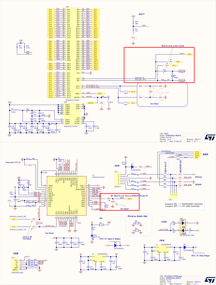

Which version of the board do you have? There should be a sticker or a silkscreened text with "MB1115" and the version.
Check, if the 8MHz crystal together with related capacitors and serial resistors/jumpers are connected on your board; and also if the connections to STLink's MCO and the pinheaders are disconnected:

Thanks for the fast and thorough reply! I have the MB1115-F411VE-D01. The Oscillator as well as the resistors and capacitors of X2 are on the board and I have also checked that that resistors have the correct resistance (0Ohm and 220Ohm) though I haven't measured the capacitors yet but I just don't think it's likely that they would be wrong or fualty on both identical boards. The oscilloscope also shows no clock signal at all on this oscillator (X2), but on the other 8MHz oscillator for the ST-Link controller (X1) it has perfect 8MHz, but I still doubt that it's actually the oscillator that is faulty since both brand new boards have the same issue. I mean if the setup fails in software it makes sense that there is no clock signal coming from the oscillator. Regarding your suggestions: The connection to the MCO is disconnected meaning the jumpers SB14 and SB16 are both open and R66 and C67 are both not on the board.
