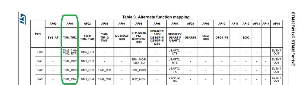

> GPIOA/B ports are enabled, set to input
They have to be set to AF in GPIO_MODER, and the appropriate AF number set in respective GPIO_AFR[].
If still in doubts, read out and post all the relevant registers content. And since you know how to program properly using registers, ditch Cube/LL, it's just an unnecessary intermediary.

This is my first time getting below the Arduino level of embedded really - how exactly do the Alt-Function things work? I'm having trouble parsing the datasheet into understanding of how I should know when to set AF in GPIO_MODER and what the settings of GPIO_AFR[] even mean - how do I know what function is what, and where, and what AFR should be?
I see the Alternate Functions and Additional Functions on the datasheet, but where should I be looking to know what bits should be set to connect, say, PA1 to TIM2_CH2 versus PA1 to TIM5_CH2?
2022-11-03 9:49 AM
The AF setting is a pin mux, associating a pin with a controlling peripheral
The setting is 4-bit allowing for up to 16 options.
PA1 would be GPIOA->AFR[0], bits 4 thru 7
GPIOA->AFR[0] = (GPIOA->AFR[0] & 0xFFFFFF0F) | (1 << 4); // AF1 on Pin 1

Oh, I see! So setting GPIOA->AFR[0] is the AFRLow and GPIOA->AFR[1] is the AFRHigh?
2022-11-03 11:00 AM
Thank you so much, your comment with the clarifications below from other folks was the one that got it working.
For anyone who googles this later, ChA and ChB of my encoder were connected to PA0 and PA1, and those port/pins were configured with AF01 to be TIM2_CH1 and TIM2_CH2 respectively. The code block is:
RCC->AHB1ENR |= RCC_AHB1ENR_GPIOAEN; // Enable RCC GPIOA
GPIOA->MODER |= 0xA; // Set PA0 and PA1 to MODER 0b10 for AF
GPIOA->AFR[0] |= 0x11; // Set PA0 and PA1 to AFR01 (TIM2_CH1 and TIM2_CH2)

Register is 32-bit wide, or hold 8 pins settings (4-bit x 8)
AFR[0] covering Pin 0 thru 7
AFR[1] covering Pin 8 thru 15
