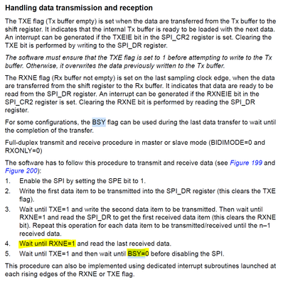

So the problem we're having is that after a write to the data register is done and a looping check made on either TXE or BSY, the chip select line is getting toggled before the 8th clock pulse happens (in the case of checking TXE, it toggles status on the 4th clock pulse, for BSY, it toggles on the 3rd clock pulse).  I will note that the RM0383 manual for this processor says "Do not use the BSY flag to handle each data transmission or reception. It is better to use the TXE and RXNE flags instead", so I suppose it's expected that bit doesn't operate as we thought it would, but why does the TXE bit toggle status before the data register's byte has even finished clocking out?  We had to work around this issue by doing a countdown for-loop but it seems like this shouldn't be necessary.
When you write a byte, it's immediately moved to the shift register. Once that happens, TXE is asserted again. This is covered in the reference manual.
For SPI, in 4 wire mode, you can wait for RXNE to get asserted to indicate the end of the transaction, as that is populated when the byte coming in is complete. You can also use BSY. The reference manual gives instructions for this.

Hello- as indicated in my message we attempted to follow item #5 but the BSY bit is not toggling at the correct time.  We had not been looking at RXNE since our SPI usage was write-only but it appears you can just let the module clock in invalid data for such cases.  Waiting for RXNE seems to be the only reliable way to make sure that the final clock pulse has happened.

you're probably hitting  http://efton.sk/STM32/gotcha/g68.html
