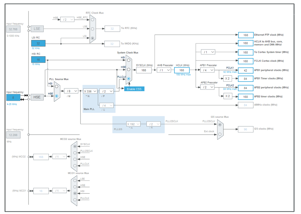

Probably You have problem with settings of SystemClock.
You have on the board STM32F4VE 8 MHz external resonator?
If yes, please change value from RCC_OscInitStruct.PLL.PLLM = 25 to RCC_OscInitStruct.PLL.PLLM = 8,
Best Regards,
Slawek
Thanks for your reply! Indeed its issue with SystemClock, I have 8Mhz external resonator, not sure why its by default 25Mhz. I have changed settings:
0693W000008wkLXQAY.pngNow I am able to send CAN BUS messages from STM32F4 and other can read them!
