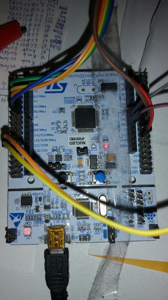

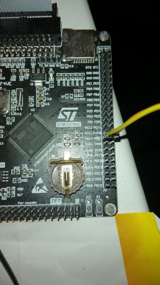

2021-03-10 12:22 PM
Do You use external transceiver CAN?
You connect directly PIN CAN1 from STM32F407 to STM32F091?
