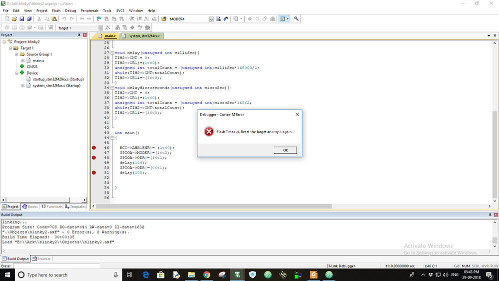

Hi folks, i have an STM32F407 discovery board. when i measure the voltage across the gpio pins it becomes write protected. after i dumped many codes but no use. i had attached the screenshot with the error code that it's display. i tried to put jumper between the boot 0 and 5v results no use. i refer so many solution and tried it but no use. so what i do now?

Hopefully not 5V, the discovery board is running the chip at 3V
You should have a while(1) loop at the end of main() so it doesn't exit.
If the ST-LINK Utilities cannot connect and erase the part with BOOT0 connected to 3V you need to consider if you have damaged the chip or other components on the board. You should perhaps review the schematic and scope some voltage points, and voltage on the VCAPs
