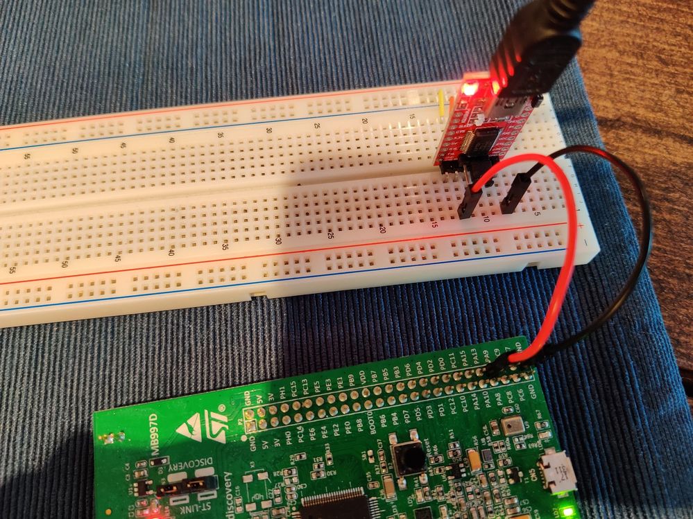

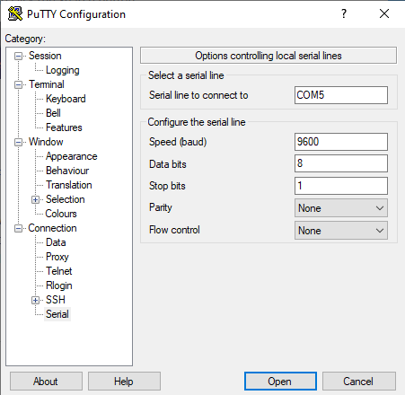

2020-07-21 11:05 PM
Hi clive1
I forgot to mention that I am using the discovery board, so you may already have known the issue upfront without going through my code. Sorry for that.
I eventually found the problem. PA9 and PA10 on the discovery board are already used for other hardware purposes, so there is a conflict when using PA9 as a TX for UART. I configured USART1 using PB6 and PB7 which are not used on the discovery board. I get the proper transmission now and everything works as expected.
