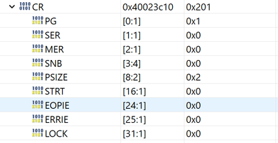

Before Error:
FLASH_CR register:
FLASH_SR register:
as you can see, PSIZE if configured correctly, but when this line of code run:

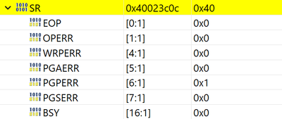

I see PGPERR: Programming parallelism error get raised even though PSIZE is configured correctly and PG bit is set to 1.

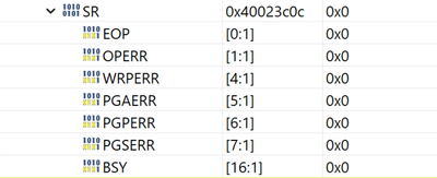

After Error:

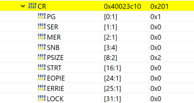

FLASH_CR register:
FLASH_SR register:

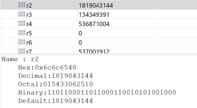

What about r2 and r3? Specifically looking to check if r3 is word-aligned.

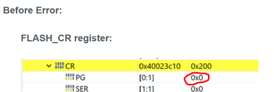

One of your screenshots has PG=0. It needs to be PG=1.
2023-08-09 12:30 PM
sorry, I posted the incorrect screenshot, it's just I have some problems dealing with the web editor of ST forums, anyways, it's 1 (I made sure it's 1), it was just incorrect screenshot
2023-08-09 1:40 PM

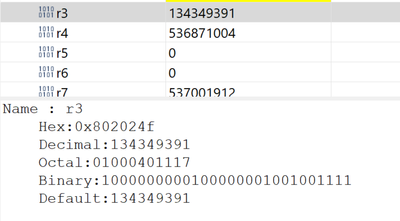

2023-08-09 8:46 PM
sure,
this is the content of R3 before STR command:
and this is the content of R2 before STR command:
2023-08-09 9:39 PM
thanks, a lot.
I discovered that the address I was trying to write to isn't word aligned
