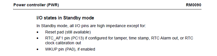

According to RM0090 Rev 18, section 5.3.6, all I/O pins are high-impedance in standby mode except for reset, PC13 and PA0, depending on how they are configured.
2019-08-21 12:47 PM

Thanks very much Bob!
