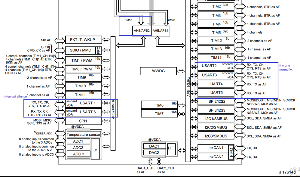

But as soon as I install the bootloader and the application, the UART DMA Tx interrupts do not work. A total of 6 UARTs are used in my system.Only UART1 and UART6 where I'm experiencing interrupt silence. UART1 and UART6 work on the APB1 line, depending on the DMA2 channel. I do not have a problem with the working uarts on the DMA1 channel. Although I turned off interrupts during application transitions, I could not solve the problem. I guess something is staying open during the migration.

Vector address at application startup = SCB->VTOR = 0x08020100
I'd like to get your opinions on the transition problem I'm experiencing between applications.
