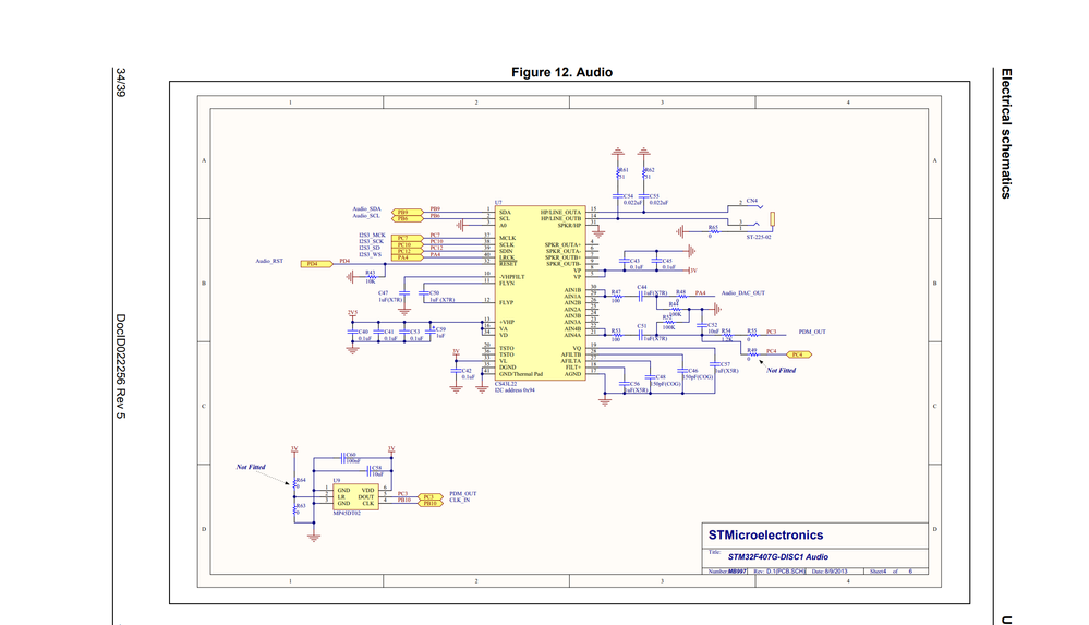

Hello @SJoo.1
According to the UM1472 page 34
I2S3_MCK (PC7) --> CLK
I2S3_WS (PC10) --> SCLK
I2S3_SCK (PC12) --> SDIN
I2S3_SD (PA4) --> LRCK
I recommend you watch this video for more information
Thx
Ghofrane
