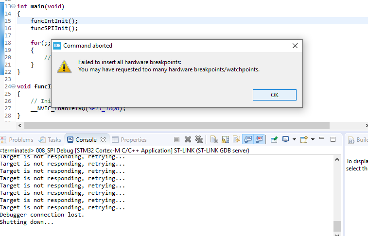

I am using the STM32F407 discovery board. Yesterday evening, I tried to init the SPI1. Then something strange happened. I suddenly receive the error message "Fail to insert all hardware breakpoints: You may have requested too many hardware breakpoints/watchpoints".
Also, the LCD based on HD44780 was working perfectly fine outputting the correct text. Now the text is either appended with a 32 constantly, or the text is flickering. So instead of saying "Alex", it says "Alex32".
Source code and console output text are given below. Any idea? I am also a little bit confused about the ST Link voltage, which is 2.88V. Is it supposed to be that voltage or may I gotten myself a hardware error?

STMicroelectronics ST-LINK GDB server. Version 5.5.0
Copyright (c) 2019, STMicroelectronics. All rights reserved.
Starting server with the following options:
Persistent Mode : Disabled
Logging Level : 1
Listen Port Number : 61234
Status Refresh Delay : 15s
Verbose Mode : Disabled
SWD Debug : Enabled
InitWhile : Enabled
Waiting for debugger connection...
Debugger connected
STM32CubeProgrammer v2.4.0
ST-LINK SN : 0671FF303431573457132556
ST-LINK FW : V2J36M26
Voltage : 2.88V
SWD freq : 4000 KHz
Connect mode: Under Reset
Reset mode : Hardware reset
Device ID : 0x413
Device name : STM32F405xx/F407xx/F415xx/F417xx
Flash size : 1 MBytes (default)
Device type : MCU
Device CPU : Cortex-M4
Memory Programming ...
Opening and parsing file: ST-LINK_GDB_server_a13704.srec
File : ST-LINK_GDB_server_a13704.srec
Address : 0x08000000
Erasing memory corresponding to segment 0:
Erasing internal memory sector 0
Download in Progress:
File download complete
Time elapsed during download operation: 00:00:00.676
Verifying ...
Download verified successfully
handle_vCont_c, Failed continue thread
Target is not responding, retrying...
Debugger connection lost.
Shutting down..."

GPIOA->AFR[1] |= (0x5<<GPIO_AFRL_AFSEL6_Pos); // PA6 to AF5 [0101]: SPI1_MISOAFR[1] is the AFRH register controlling the function mappings of pins PA8-PA15. So the debugger interface becomes misconfigured at this point.

2020-06-21 12:31 AM
Whoooop whooop - you made my day berendi. You have my eternal gratitude.
This code snipped would probably be the last spot to look for the reason. I just confirmed that I need to pay more attention.
