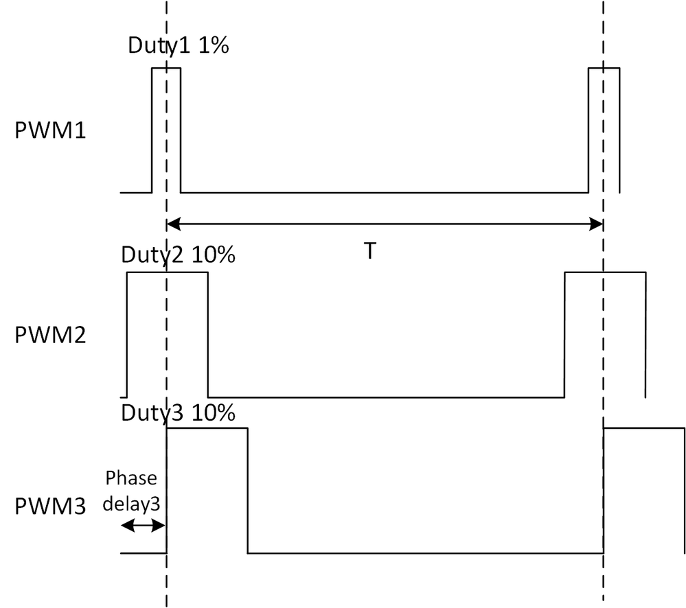

I'm using STM32F407 Black VET6 board. I need to create 6 center-aligned synchronized PWM signals with the same frequency, but every signal needs to have its own DutyCycle and PhaseShift control. Example of 3 signals is given in them image below. I have read

I need six variable phase and duty PWMs. Every PWM should have independent phase and duty. All six PWM must be in sync around a reference point (dashed line in the image above). Frequency is fixed. Max frequency is 24 kHz. Resolution (phase and duty) must be 10 bits or more.
