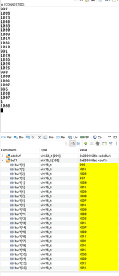

Good morning everyone, after collecting some data and storing it in various buffers, I am trying to write them to the serial port for further processing. I am experiencing issues as I can see that something is being written to the serial port, but not all the samples in the buffer are being printed. Any suggestions?

So show what is in buf1 array, and what you're seeing being printed. And what are you printing to?

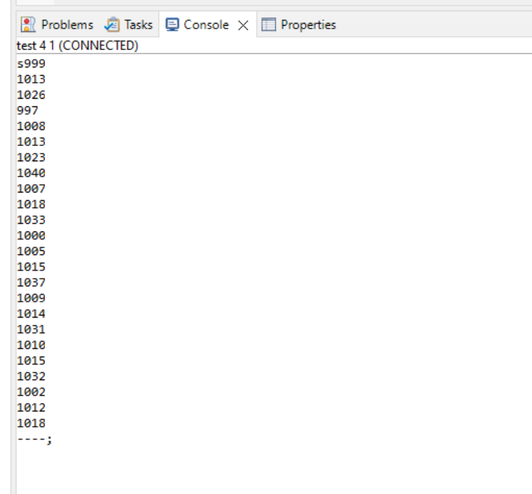

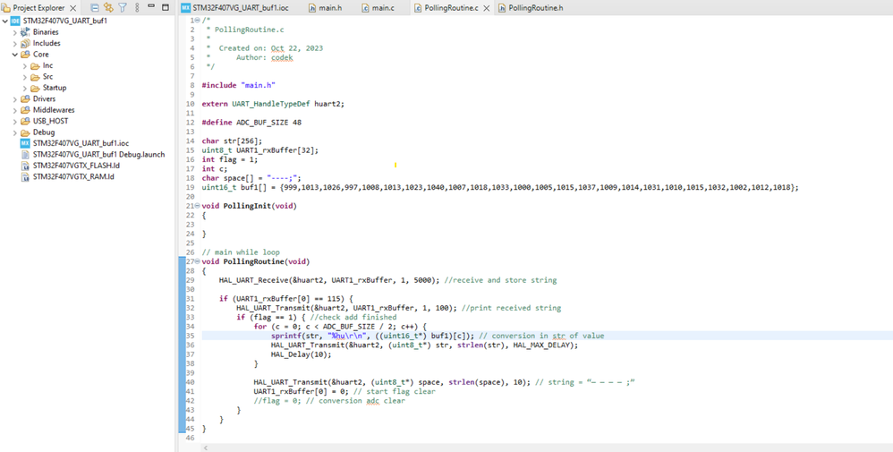

2023-10-24 3:03 AM
So what interface are you using to communicate with uart2? I suspect that is your weak link.
I am using a STM32F407VG-Discovery, used your code and saved the same data that you've provided. When i press the letter 's', I am able to output all the data correctly.
2023-10-24 3:18 AM
I am using a TTL converter because via usb I cannot see the serial port. Is there some setting I'm missing?
