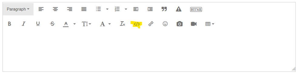

Use code formatting so it is easier to read the code
