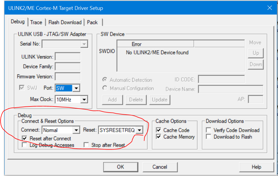

uVision uses the methods to RESET the part: you can select them here:
A ULINK D is a ULINKpro without ETM instruction trace. SWV works fine.
