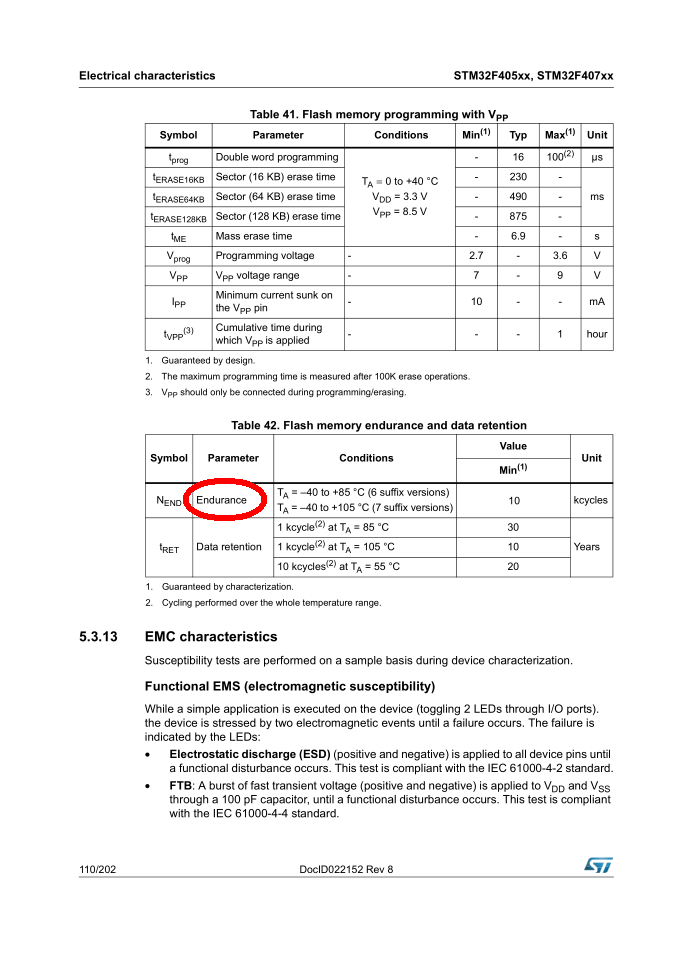

Either I checked the wrong datasheets, use the wrong keywords, am blind or the answer is in a source I didn't find or check.
Please help
2018-08-17 2:41 AM
if you happen to know the answer, please also provide the source.
2018-08-17 3:16 AM
Source: STM32F407 datasheet.
Keyword: endurance.
2018-08-17 6:00 AM
oh, Thanks a lot.
don't know how I could miss this when I had it in front of me.
