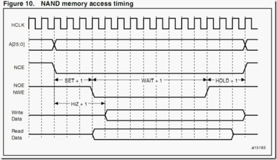

waclawek.jan , FMC in NAND mode has the ability to set variable HOLD Time. See picture attached under this post.
I successfully tested my LCD with this code:

ComSpaceTiming.SetupTime = 0; //+1 1CLK = 5ns >= 4ns
ComSpaceTiming.WaitSetupTime = 3; //+1 4CLK = 20ns >= 18ns 1CLK уже мало
ComSpaceTiming.HoldSetupTime = 3; //+0 3CLK = 15ns >= 15ns 1CLK уже мало
ComSpaceTiming.HiZSetupTime = 1; //+0 1CLK = 5ns (tSET=tHIZ) >= 4ns 0CLK работает (0CLK: данные по�?в�?т�?�? �?разу по�?ле падени�? NCE, 1CLK: по�?ле падени�? NWE, >1CLK: ещё позже)

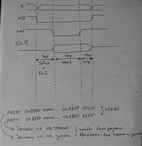

LCD IO for write (fast timings):
#define LCD_WR_COM16 (*(volatile unsigned short int*) 0x80000000)
#define LCD_WR_DAT16 (*(volatile unsigned short int*) 0x80010000)
LCD IO for read (slow timings):
#define LCD_RD_COM16 (*(volatile unsigned short int*) 0x88000000)
#define LCD_RD_DAT16 (*(volatile unsigned short int*) 0x88010000)
Total speed in my case for LCD: 200MHz/(1+4+3)=25 MHz

Early, I wrote about it here (most full description + pictures): https://electronix.ru/forum/index.php?showtopic=148029
