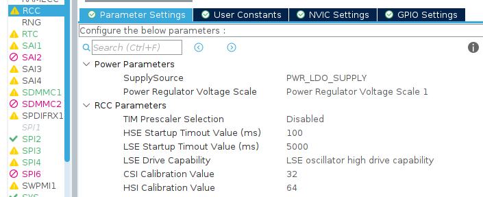

Could you refer to AN2867 Rev16? Special focus on section 3.4, make sure that Gm_crit_max (MCU) > gm_crit (crystal). Also, section 3.3 to calculate the external capacitors then fine tune.
As mentioned in RM0399 Rev 3, section 9.7.25, before writing into RCC_BDCR.LSEDRV to change the drive level. The BDCR write protection should be disabled.
