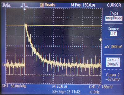

@ONadr.1 - I measure no current into VBAT when VDD is off, but that may just be that the current is too low and in the noise floor of my 1 V/A current monitor. I'll work on setting up a uA-range current measurement.
There's a current spike into VBAT when VBAT is off, but connected to a PSU, and VDD is applied (no current spike if not connected to PSU). I don't see any current on VBAT if it's on when VDD is applied. Peak is 260 mV, which equates to 26 mA (1 V/A + 10x turns of wire around probe). I don't know what, if anything, can be inferred from this.
