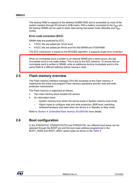

> This STM32H7 ECC issue is a major gotcha, IMHO should be included in the errata for all affected products.
It's in the RM, at least for 'H743 and kin:
