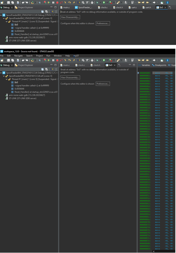

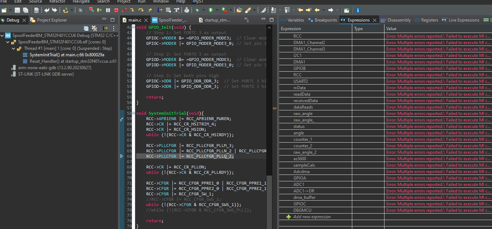

Below I attached some pictures of the steps it takes while crashing.

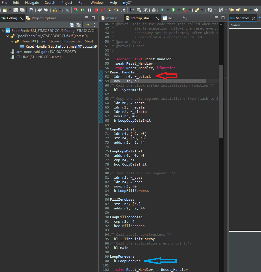

In the last picture it starts at the RED arrow and STEPS all the way down to line 100 Blue arrow and then jumps back up to the RED arrow after which it crashes.

Probably it's in an error handler, perhaps the hard fault handler.

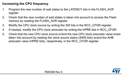

84 MHz is going to require nonzero wait states before you switch to that clock.

@Tesla DeLorean This is another strange thing going on. All the registers have this Error message while I can still step through. If I use the HAL generated code it runs fine.
@TDK Sorry but I am not 100% sure what the flag is I have to watch to be ready?

Error kind of implies the debugger's having a hard time accessing memory. These aren't my tools, I'm not using them like this.
