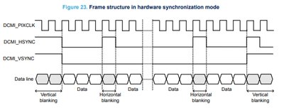

Figure 23. in AN5020 shows an example of data transfer when DCMI_VSYNC and DCMI_HSYNC are active high, and when the capture edge for DCMI_PIXCLK is the rising edge.
You need to make sure that DCMI_HSYNC and DCMI_VSYNC polarities are programmed according to the
camera module configuration. In the hardware synchronization mode (ESS = 0 in DCMI_CR), the IT_VSYNC
interrupt is generated (if enabled), even when CAPTURE = 0 in DCMI_CR.

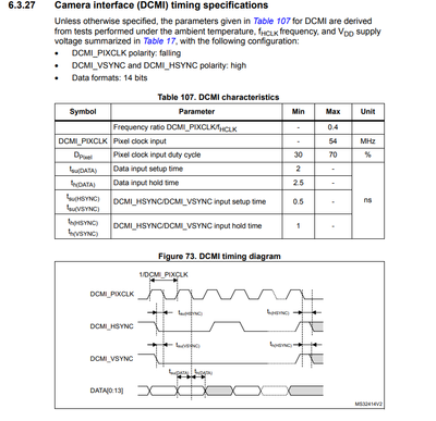

For more details about the DCMI clock timing, I recommend you to look at STM32F4 datasheet.
If you use STM32F437, you can refer to DS9484
