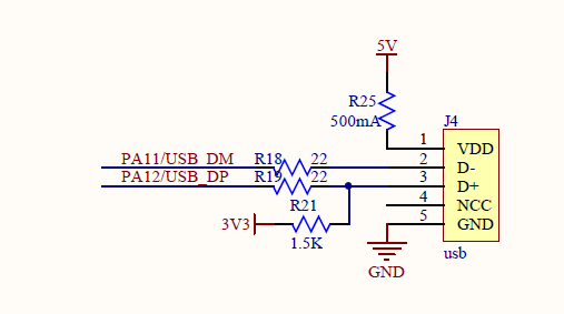

I am testing out the USB HID (otg fs) feature of my board with stm32f407vet6 mcu. I used stm32cubemx to configure it and i didn't add anything to the while loop in main c, just seeing if the device can be detected or not. However, after I uploaded the code and resetted the board, no response was given and I could not find any relevant port in the device manager of my pc. The attached are the schematic for the usb_slave port and configuration in stm32cubemx.

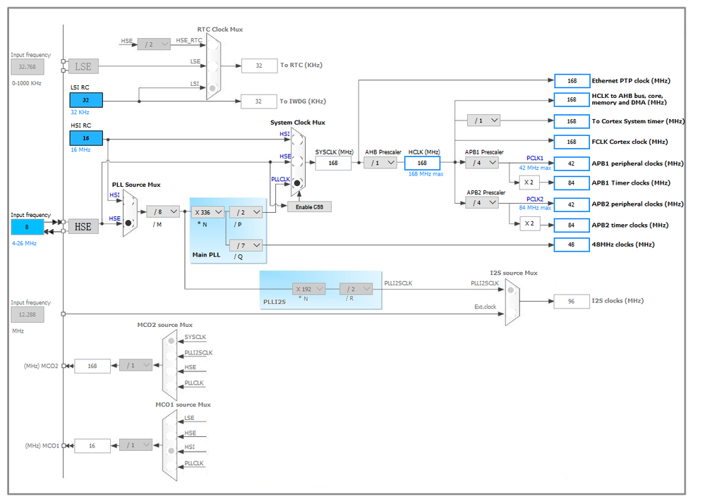

,Can you show us your clock configuration? Clock is in most cases main problem why USB does not work.

Hi
Majerle.Tilen
This is my clocking configuration; the clocking for usb is 48Mhz I think.

The problem is solved. It turns out that in the schematic I pulled up the PA12(D+) pin to make the host device recognize the board as a full speed device. However, it is not necessary and is wrong. I only need to connect PA12 directly to the D+ in usb connector and it works fine.
