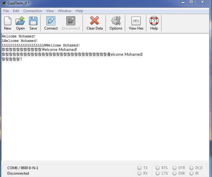

Thanks for your reply. I tried your fix but still the same problem occurs.
here u can find a screenshot of my ouput.2016-10-05 7:00 PM

I tried both of em, putchar return me those weird char, puts return me nothing and the serial doesnt receive anything.

Ok, I see the issue now, I should be using GetFlagStatus not GetITStatus, the defines for the latter are different. I'm also front testing that the TX register is empty before writing to it, not after.
