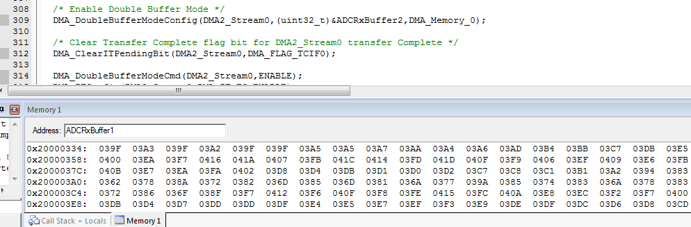

I have been playing with ADC of stm32f4, i triggered ADC with TIM4_CC4 event to sample at 8Khz, using DMA. All individual components are working well but once combined i get alternate samples missing, i observe it using debugger. Data is correct as i am giving sinusoidal signal and data values seems to be correct but every alternate sample is simply 0. I am posting my code if anyone could guide, it would be great help.ADC_InitTypeDef ADC_InitStructure; ADC_CommonInitTypeDef ADC_CommonInitStructure; DMA_InitTypeDef DMA_InitStructure; /* RCC clock settings and GPIO settings for ADC3 channel 11 */ RCC_Configuration_ADC3(); GPIO_Configuration_ADC3(); TIM4_Configuration(); // set at 8KHz /* NVIC interrupt enable for DMA2 Stream0 */ ADC3_DMA2_Stream0_Interrupt_Enable(); /* RCC clock settings for DMA2 */ RCC_AHB1PeriphClockCmd(RCC_AHB1Periph_DMA2, ENABLE); /* DMA2 Stream0 channel2 configuration **************************************/ DMA_InitStructure.DMA_Channel = DMA_Channel_2; DMA_InitStructure.DMA_PeripheralBaseAddr = (uint32_t)ADC3_DR_ADDRESS; DMA_InitStructure.DMA_Memory0BaseAddr = (uint32_t)&ADCRxBuffer1; DMA_InitStructure.DMA_DIR = DMA_DIR_PeripheralToMemory; DMA_InitStructure.DMA_BufferSize = BUFFER_SIZE; DMA_InitStructure.DMA_PeripheralInc = DMA_PeripheralInc_Disable; DMA_InitStructure.DMA_MemoryInc = DMA_MemoryInc_Enable; DMA_InitStructure.DMA_PeripheralDataSize = DMA_PeripheralDataSize_HalfWord; DMA_InitStructure.DMA_MemoryDataSize = DMA_MemoryDataSize_HalfWord; DMA_InitStructure.DMA_Mode = DMA_Mode_Circular; DMA_InitStructure.DMA_Priority = DMA_Priority_High; DMA_InitStructure.DMA_FIFOMode = DMA_FIFOMode_Disable; DMA_Init(DMA2_Stream0, &DMA_InitStructure); /* Enable Double Buffer Mode */ DMA_DoubleBufferModeConfig(DMA2_Stream0,(uint32_t)&ADCRxBuffer2,DMA_Memory_0); /* Clear Transfer Complete flag bit for DMA2_Stream0 transfer Complete */ DMA_ClearITPendingBit(DMA2_Stream0,DMA_FLAG_TCIF0); DMA_DoubleBufferModeCmd(DMA2_Stream0,ENABLE); DMA_ITConfig(DMA2_Stream0,DMA_IT_TC,ENABLE); DMA_Cmd(DMA2_Stream0, ENABLE); /* ADC Common Init **********************************************************/ ADC_CommonInitStructure.ADC_Mode = ADC_Mode_Independent; ADC_CommonInitStructure.ADC_Prescaler = ADC_Prescaler_Div4; ADC_CommonInitStructure.ADC_DMAAccessMode = ADC_DMAAccessMode_Disabled; ADC_CommonInitStructure.ADC_TwoSamplingDelay = ADC_TwoSamplingDelay_5Cycles; ADC_CommonInit(&ADC_CommonInitStructure); /* ADC3 Init ****************************************************************/ ADC_InitStructure.ADC_Resolution = ADC_Resolution_12b; ADC_InitStructure.ADC_ScanConvMode = DISABLE; ADC_InitStructure.ADC_ContinuousConvMode = DISABLE; ADC_InitStructure.ADC_ExternalTrigConvEdge = ADC_ExternalTrigConvEdge_Rising; ADC_InitStructure.ADC_ExternalTrigConv = ADC_ExternalTrigConv_T4_CC4; ADC_InitStructure.ADC_DataAlign = ADC_DataAlign_Right; ADC_InitStructure.ADC_NbrOfConversion = 1; ADC_Init(ADC3, &ADC_InitStructure); /* ADC3 regular channel11 configuration *************************************/ ADC_RegularChannelConfig(ADC3, ADC_Channel_11, 1, ADC_SampleTime_3Cycles); /* Enable DMA request after last transfer (Single-ADC mode) */ ADC_DMARequestAfterLastTransferCmd(ADC3, ENABLE); /* Enable ADC3 DMA */ ADC_DMACmd(ADC3, ENABLE); /* Enable ADC3 */ ADC_Cmd(ADC3, ENABLE); #stm32f4 #stm32 #discovery #selective-cut-n-paste #adc-and-dma2014-03-27 5:35 PM

sample_buffer_ping[0] &[2] is correct, sample_buffer_ping[1] & [3] = 0 and so on...sample_buffer_pong[0] &[2] is correct, sample_buffer_pong[1] & [3] = 0 and so on...same behavior is observed for both the buffers... i used the same DMA double buffer configuration for duplex I2S interface and it was working good. have increased sample time still no success.As i am giving sinusoidal signal and correct data [0] & [2] seems to be making sinusoidal signal.Each buffer size is 1024, and it is taking 128ms for each buffer to fill completely which is correct for 8kHz sampling time. example data :buffer1 = {2722, 0, 2162, 0, 1535, 0, 1226, 0, 1453, 0, 2049, 0, 2647, 0, 2869, 0, 2576, 0, 1962, 0, 1400, 0, 1240, 0, 1610,.....}buffer 2 = {1242, 0, 1380, 0, 1933, 0, 2571, 0, 2865, 0, 2656, 0, 2049, 0, 1458, 0, 1231, 0, 1526, 0, 2125, 0, 2707, 0, 2868,.....}2014-03-27 11:44 PM

Seems to work fine for me, what are you debugging with? CooCox?
2014-03-29 4:31 AM
Thanks alot clive for your support, my problem is solved now. I was indeed debugging with coocox. Problem was a ridiculous mistake on my end. Now i am able to make ADC & DAC to work at 8kHz with double buffer DMA at both ends. Thanks again.
