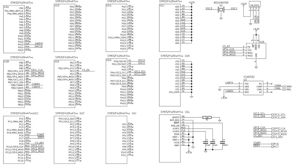

2018-03-30 1:41 AM
I am adding my schematic for info, could this be something to do with the internal regulator..?

I have tested 3 pieces of hardware all exhibiting the same fault - 2 have been professionally fitted, and 1 by me! The resonator is specified to 125C, at 0.1%, so I don't suspect that - and I have used it in the past on STM32F103's without issue. I'm currently playing around with :
__HAL_PWR_VOLTAGESCALING_CONFIG(PWR_REGULATOR_VOLTAGE_SCALE1);
//settings,
Clive also mentioned FLASH LATANCY settings, but not sure what impact this will have on temperature...
Here is my full config...

2018-03-30 4:47 AM
Ah so it's BGA? Can't this simply be a case of bad joints on some of the supply/ground pins? Do you have multiple pieces of hardware exhibiting the same symptom?
Also, can't the 'resonator' be a source of temperature-dependent issues?
To be honest, I'm not exactly sure what it is doing.
So how does it fail short of expectations and what those expectations were? In other words, how do you know it 'stops running'?
In cases like these you should devise simple tests, run them and observe the results.
2018-03-30 5:42 AM
The resonator
The oscillator circuit is an analog thing, it may go awry with temperature-induced changes in its parameters - including the amplifier internal in STM32. In other words, the component may be good to 125deg.C but the oscillator as a whole system may fail.
What's it frequency? What's the system frequency? How do you use the Q tap of the PLL?
And you still haven't answered the main question, what are symptoms exactly and why do you think it's a failure?
