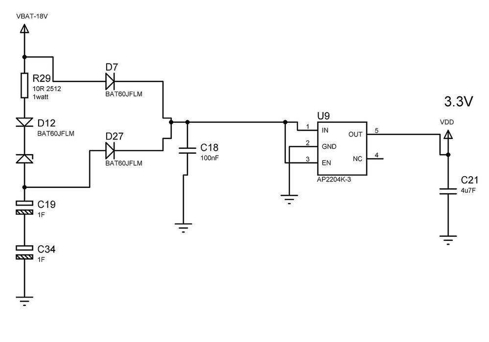

Hello ;
I am using STM32F405 in my device ; I have some problem to configure the device in very low power mode ; The device should work from 18V/5000mah battery . The device should do selftest everyday : I use RTC alarm to wakeup from standby mode. The device should give an alarm if the battery is not connected ; what I do now is I charge a supercap and put the device in standbymode ; the supercab and teh battery are connected to LDO that power the STM32F4 ; STM32F4 is in standby mode either wakeuo by RTC alarm very one hour to check if the battery removed or not either wake up by a wakeup button for normal operation of teh device . I need the total current being consumed from teh battery to be less than 100uA while I know the standby mode of stm32f4 is about 20uA ( max ) . but I am getting 800uA ! ; I think it is due to the supercap or to the LDO ; But I have to put LDO ; DO you sugegst any other idea for this issue ? Down is the shematic of the power2016-08-20 5:47 AM
How is the VBAT connected on the STM32F4 side?
What is the part# for the super-cap? Could they be on the low voltage side? You have an enable pin on the LDO, so you can easily turn that off. Is the 3V3 powering other things?2016-08-20 7:26 AM
Hi Clive ; Tobe honest I was waiting your reply ; thank you first .
The LDO have to be on all the time because the MCU in standby mode and waiting for wakeup PA0 or RTC alarm ; the supercaaps are 2 capacitors in series C19 and C34 . the 3.3 is only powering the MCU and connected to Vbat too .2016-08-20 8:44 AM
Yes I can see how you have them in series, I'm interested in the specific part number.
You can power the F4 while it is in standby via the the VBAT pin, I think a diode and super-cap arrangement there to power VBAT, and VDD absent the primary supply, and a way of enabling the LDO as it exits STANDBY. ie a GPIO with a weak pull-down, that is driven high by some very compact code in Reset_Handler A super-cap on the low voltage side would be more efficient, and still permit you to swap out the 18V battery.2016-08-21 3:36 AM

Hi Clive ;
