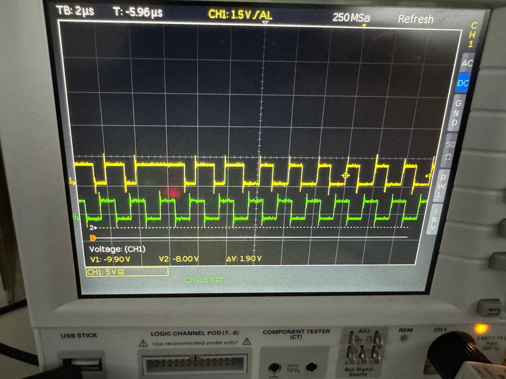

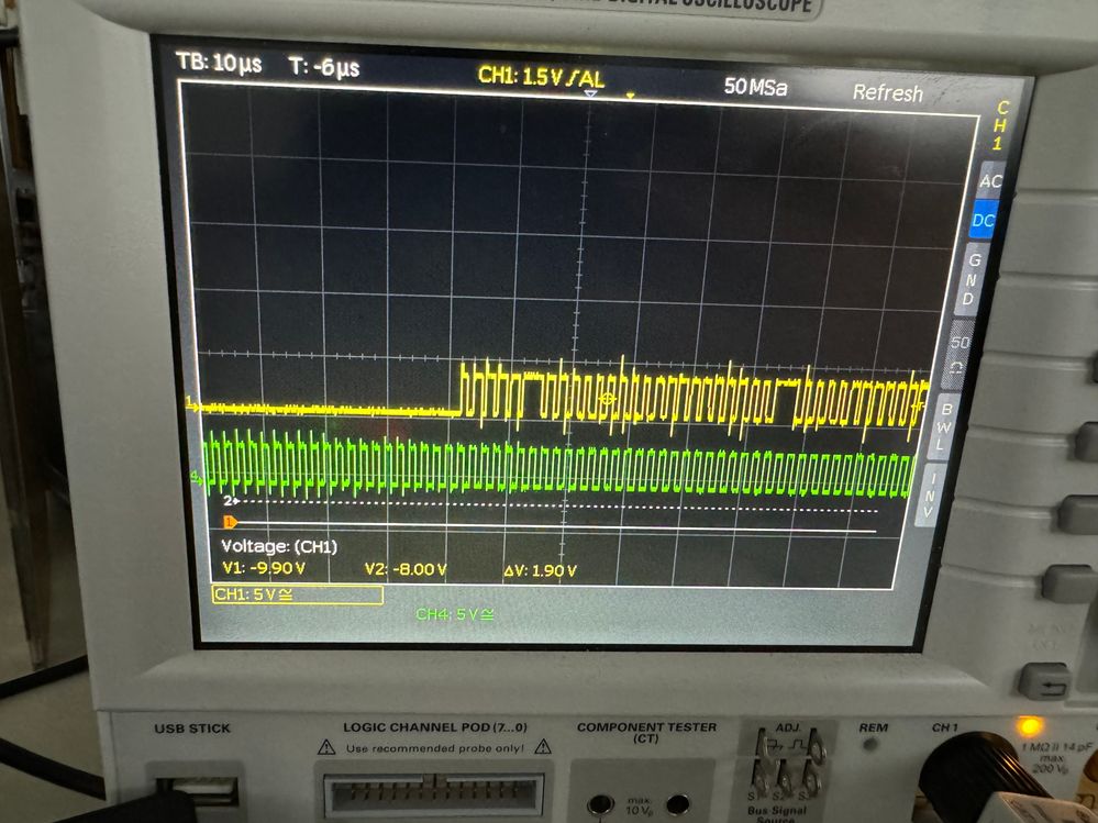

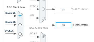

ok, I think I have nailed the ADC parameters with the signal and I can see better output results in the oscilloscope. I see the frequency on the pyboard to 500kHz and the ADC is configured to the max sampling frequency with two ADC. However, I see some gaps, see the screenshots. The green one is the input signal and the yellow is the signal I generate based on the ADC values.
In this one, the generated signal is a bit shifted/delayed compared to the input signal, but it matches most of the time, ignoring the wide one on the left side which I don't know what happened.

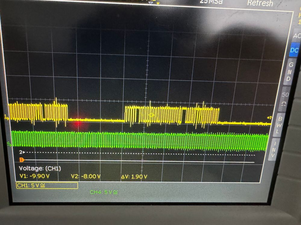

If I zoom out the gaps a more dramatic:
Is it possible to know what could be causing these, or how could they be corrected?
I removed any possible interrupt or print (even with DMA) to avoid any problem in the signal generation. I found my printf with DMA was causing the output signal to malform and not reflect the ADC values correctly.
