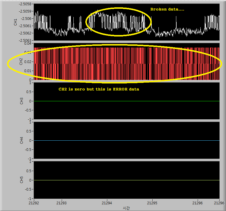

The error is occurring ♯ 4,7,10,13,16,19,22,25 bytes LSB bit.
For example,
ADS1299 send 0xC0 0x00 0x00 0x45 0x20 0xD0 0x00 0x00 0x00 ......... 0x00(27th byte)
STM32 SPI receive
0xC0 0x00 0x00 0x44 0x20 0xD0 0x01 0x00 0x00 ......... 0x00(27th byte)
The 4th and 7th byte change or not change randomly.......

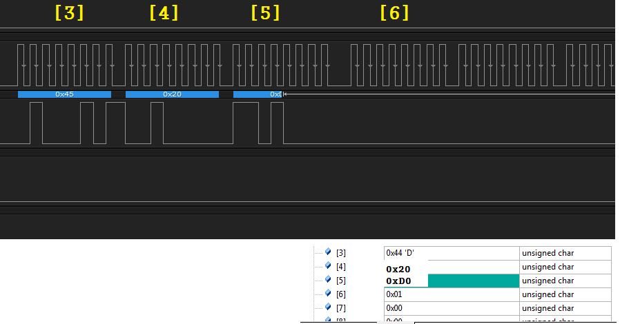

I check ADS1299 output data using logic analyzer. MISO data is fine.

See erratum titled Corrupted last bit of data and/or CRC, received in Master mode with delayed SCK feedback

I solve the problem by you answer.
