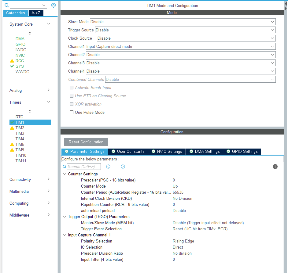

I've read AN4666 but the examples provided are written using an obsolete library, not HAL. But I understood that I have to use a Timer in Input Capture mode to activate the DMA transfer. To do this, in CubeMX I configured TIM4 as follows:

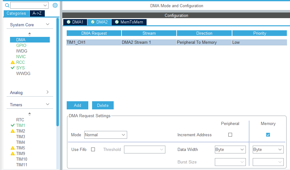

Then in the DMA Settings tab I added one line:
Does this configuration make any sense? My idea is to transfer the contents of register GPIOC->IDR (dimension: Word 32bit) to a uint8_t buffer (dimension Byte 8bit).

Look at Fig.1 in the RM.
Even if the two DMAs are almost identical in their working and have identical registers, their connection within the system is not the same: the Peripheral port of DMA1 has no connection into the busmatrix, but is connected directly to the APB1 bus.
Even the Memory port of DMA is not connected to all resources on the busmatrix, only to the memories.
So to access GPIO, you have to use DMA2, thus TIM1 (or TIM8 if your variant of 'F4 contains it).

Nice, makes sense thanks. Would never occurred me to take a look at first figure if the manual. Now I guess that Figure 23 could also be valid to understand this fact.
I will now share my configuration for a sample demo that captures 8-bit data from GPIOC pins 0-7 when a button connected to TIM1 channel 1 in Input Capture mode (also called Compare in TIM1) is pressed. The program sends through UART the data nicely formatted. When the serial transfer is complete a UART TransferComplete interrupt enables again DMA for a new transfer.
A couple of quirks: if the timer is used just as a mean to trigger DMA or a IC interrupt, it doesn't need to have the clock enabled. Another maybe strange thing is that DMA is configured to move bytes, while the GPIOC IDR register is 32 bit, although 16bits are reserved. The motivation of this choice is that in my application I can use the first 8 contiguous pins as in input. This allows me to use a receiving buffer of bytes, saving memory.
