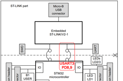

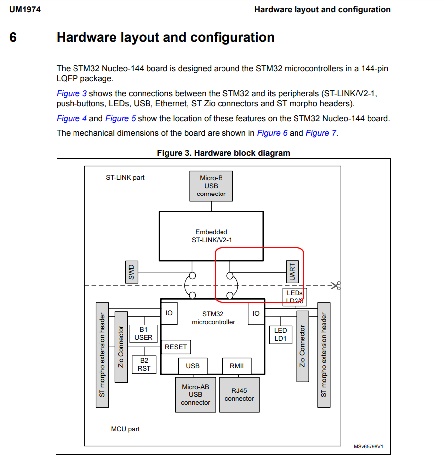

@QuangIoT wrote:I'm using this cable and i ensure correct communication standard
That's the USB cable which connects the ST-Link to your computer.
That's what carries the debug/programming connection, and the VCP (Virtual COM Port)

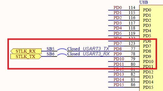

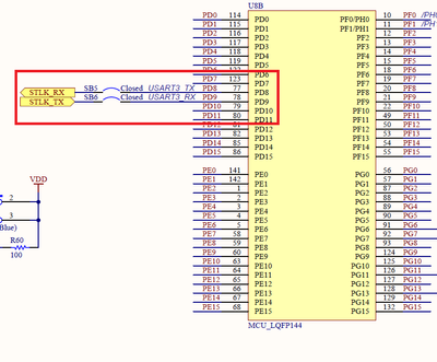

As pointed out by @mƎALLEm, that VCP is connected to USART3 (PD8 & PD9) on the STM32F4 microcontroller.
So, if you want to use USART3 to communicate with any external device, you are first going to have to disconnect it from the ST-Link VCP - that's what the SB5 & SB6 links are for:
Of course, once you've disconnected them from the ST-Link, then you will no longer be able to communicate over the VCP - you will need a separate USB-to-UART converter.
Similarly, if you use any other UART connection than PD8 & PD9, that will not be connected to the ST-Link and, therefore, will not be accessible via the ST-Link's VCP - so you will, again, need a separate USB-to-UART converter.
