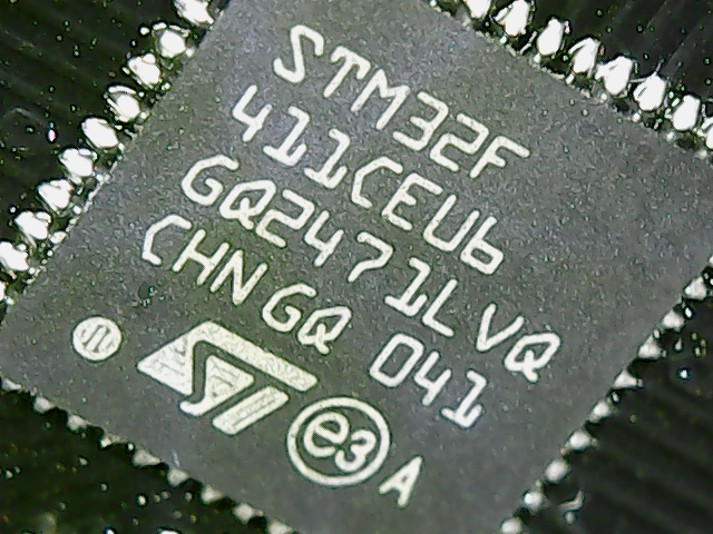

2023-12-07 12:03 PM
Perhaps a high resolution picture, in focus, of the F411 component/board ?
