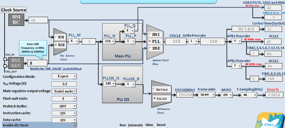

I am using stm32f4 dev kit for making that things work.
I use I2S_Mode_MasterRx for I2S module(SPI2).void SPI2_IRQHandler(void) {

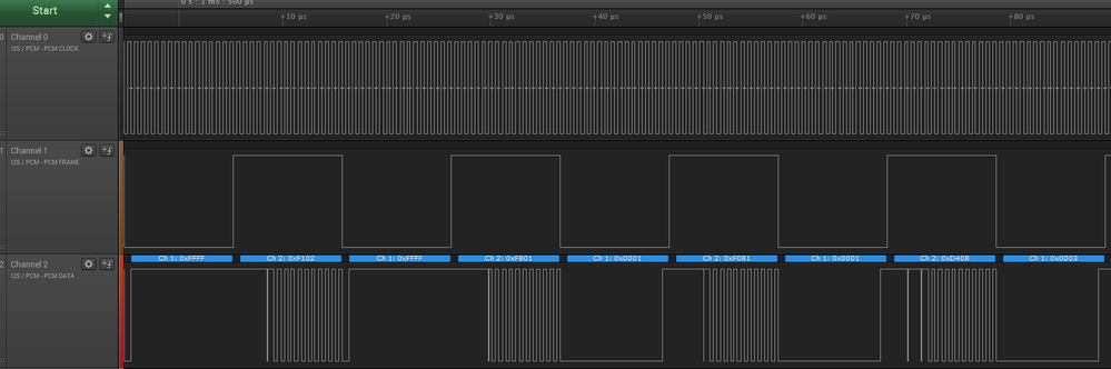

} But i got the following diagram it seems to me the i2s does not work well any ideas?
2016-10-29 2:52 PM
Why do you think so? The master receiver should provide the bit clock and frame/wordselect/LR clock, and according to that waveform you have both of them. The data come from the transmitter, I can't judge whether they are OK - is LR grounded i.e. mic is attempting to output on left channel? Is this waveform taken at the powerup or later? JW2016-10-30 11:09 AM

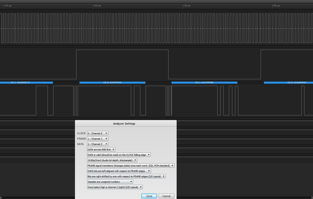

> LR is grounded as a result we use ch 2
From ICS43432 datasheet: i.e. if LR is grounded, it's the *left* microphone i.e. data is output when WS is low (ch1). What we see in ch2 is a floating (hi-Z) line, capacitively coupled to the data clock, IMHO. Now 0x0000 and 0xFFFF is suspicious, but that's why I asked, which portion of data do we see, whether it is after the powerup or later. The ICS43432 states a rather lengthy (in terms of clocks) startup during which the data are invalid, and then a gradual fade-in (unmute). JW2016-10-31 7:50 AM
I have added right micro and redone the test
also - I2S_InitStructure.I2S_DataFormat = I2S_DataFormat_24b;(The output data word length is 24 bits/channel) - The data word format is 2?s complement, MSB first for ICS43432 I2S Digital Microphone -The SD trace should have a pulldown resistor to discharge the line during the time that all microphones on the bus have tri-stated their outputs. A 100 k? resistor is sufficient for this, as shown in Figure 10. If the SD line needs to be discharged faster than a 100 k? resistor can, a smaller resistor, such as 10 k?, can be used. but nevertheless i see this result time, ch, value 1.156853416666667,1,0xFFEF0E 1.156863750000000,2,0x0002EF 1.156874083333333,1,0xFFFBA2 1.156884375000000,2,0x0007E3 1.156894708333333,1,0xFFF691 1.156905041666667,2,0x0006FC 1.156915375000000,1,0xFFF3C7 1.156925666666667,2,0x0003B9 1.156936000000000,1,0x7FF83B 1.156946333333333,2,0x000C46 1.156956666666667,1,0xFFF670 1.156967000000000,2,0x00060F 1.156977333333333,1,0xFFFDDD 1.156987625000000,2,0x00043C 1.156997958333333,1,0xFFFC44 1.157008291666667,2,0x0007FC 1.157018625000000,1,0xFFFF0E 1.157028916666667,2,0x0005E4 1.157039250000000,1,0x7FFF07 1.157049583333333,2,0x000618 1.157059916666667,1,0x000116 1.157070250000000,2,0x000202 1.157080541666667,1,0x0000C0 1.157090875000000,2,0x0006F8 1.157101208333333,1,0x00000F 1.157111500000000,2,0x8001FF 1.157121833333333,1,0x00017F 1.157132166666667,2,0x000223 1.157142500000000,1,0x000306 1.157152791666667,2,0x0003FB 1.157163125000000,1,0x0004C3 1.157173458333333,2,0x0001F9 1.157183791666667,1,0x0002E1 1.157194125000000,2,0x0003E1 1.157204416666667,1,0x0001A4 1.157214750000000,2,0x7FFF73 1.157225083333333,1,0x000780 1.157235416666667,2,0x0002F2 1.157245708333333,1,0x00045E 1.157256041666667,2,0x0004F7 1.157266375000000,1,0x000877 1.157276708333333,2,0xFFFFEF 1.157287041666667,1,0x000CDA 1.157297333333333,2,0x000407 1.157307666666667,1,0x00071E 1.157318000000000,2,0x0001E3 1.157328333333333,1,0x0003A1 1.157338625000000,2,0x00040F 1.157348958333333,1,0x0007EE 1.157359291666667,2,0x000666 1.157369625000000,1,0x0001C3We’re moving the ST Community to a new platform to give you a better and more reliable community experience.
