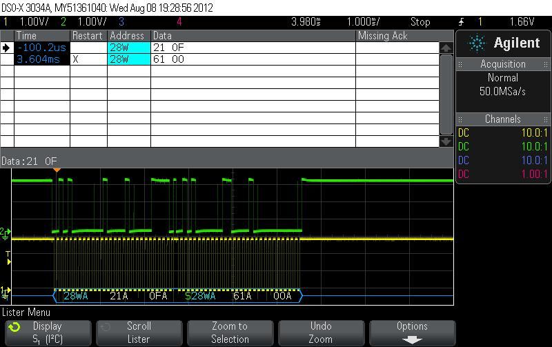

I still believe I am having issues with the I2C, specifically with the start and stop sequences. Below is a screenshot of what I'm seeing. The I2C address and data are definitely being acked, but Even though I have:
I2C_GenerateSTART(I2C, ENABLE);....I2C_GenerateSTOP(I2C, ENABLE);It doesn't seem like I'm seeing the start or stop. As you can see there is a restart event between my messages, implying no stop.2012-08-08 8:51 AM
Actually, it appears the start is working, just not the stop. Here's what I'm doing for my stop:
I2C_GenerateSTOP(I2C, DISABLE);I2C_ClearFlag(I2C, I2C_FLAG_STOPF);/* Send STOP condition */I2C_GenerateSTOP(I2C, ENABLE);while(I2C_GetFlagStatus(I2C, I2C_FLAG_STOPF)); // stop bit flagWe’re moving the ST Community to a new platform to give you a better and more reliable community experience.
