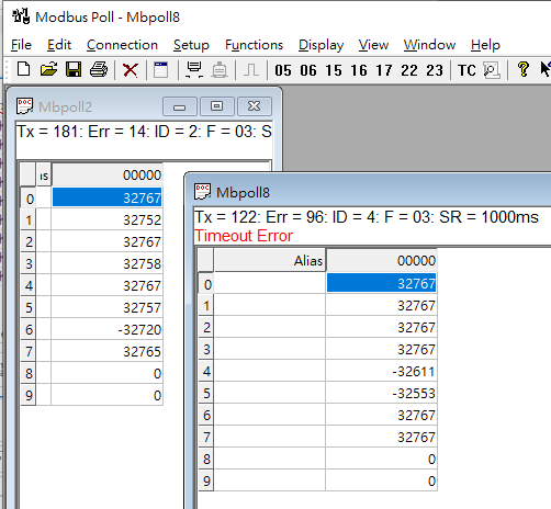

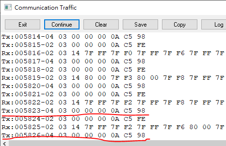

when i polling the mcu1 only, the rxbuffer from DMA is correctly(modbus-rtu query package)
when i pooling mcu1(slaveID 2) and mcu2(slaveID 4), the package will be shift or incorrect.

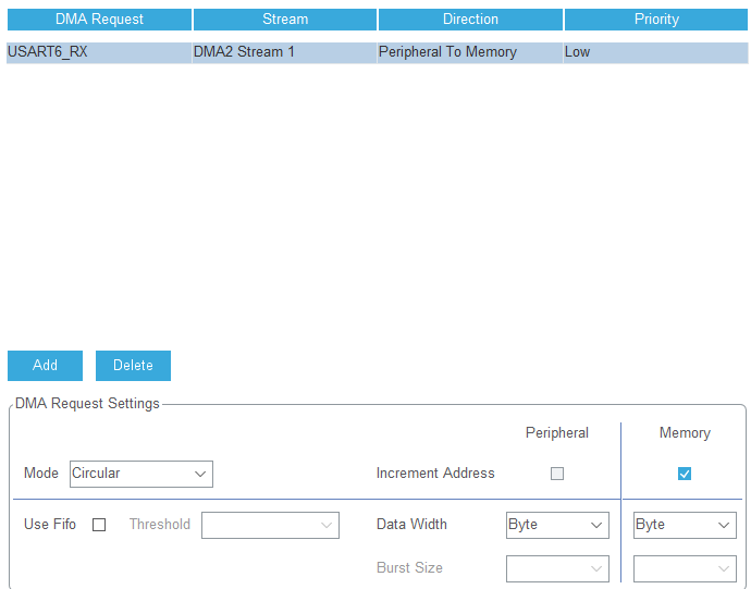

my DMA parameter

i 'm sure that the modbusPoll(master) send the correct package

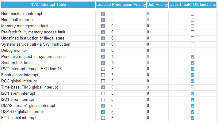

Sounds like a similar problem to this. Try to do what I've recommended there. Maybe the ISR is too slow or some other ISR blocks it for too long so that data are missing.
