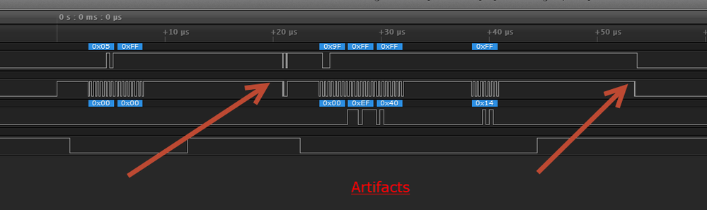

Thanks - I was looking at other posts that suggested changing to a union in the SPI typrdef but your suggestion was much better. I implemented suggestion and it addressed the byte transmit size but produced a delay and artifacts that are disturbing. The SPI process activity is extended beyond the transmission of the intended bytes - actually delaying operation also.

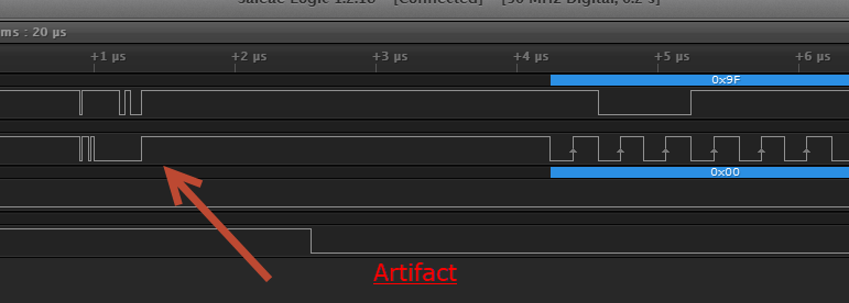

I've expanded the Artifacts to show MOSI and Clock activity.

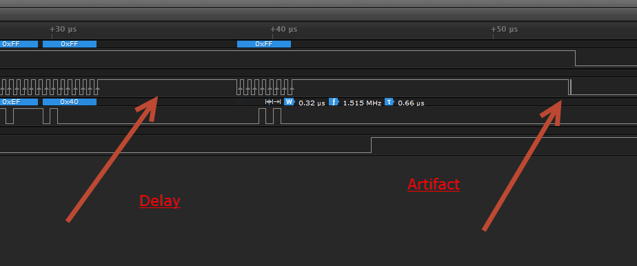

The second SPI activity was a single write command then read 3 bytes. You can see the SPI delayed between acquiring the second and third byte and also generated an artifact.
I am controlling the SPI chip select directly with GPIO- that is why you see the CS go inactive before the SPI completes with the artifact generation.
Any comments/help?
Thanks
2021-02-02 11:04 PM
Doesn't look like that this is related to the DS assignment. Hard to tell what happens without seeing the code. Could the lines be in HiZ mode (disabled?) or weak signals at the probes. Looks more like random noise than SPI related...

I figured out the delay. I poll SR once in the interrupt routine - processing receive prior to transmit. The delay is just process time between acquiring data once the fifo is empty. On the artifacts - the device I am writing/reading from is a serial flash memory device which would make the MISO go HI Z when the CS goes HI. But the artifacts are on the SPI MOSI and clock line which (I believe) are being driven (not HI Z) until the SPI is disabled. I disable the SPI just after setting CS HI - but you can see it takes the SPI over 7 usec to actually disable as shown when the clock returns to it's steady state LO. Thoughts?
2021-02-03 12:09 PM
Hi-Z means, there's nothing driving the pin. What you see is time until some parasitic leakage discharges the parasitic capacitance of the given track to the threshold of the LA's input.
