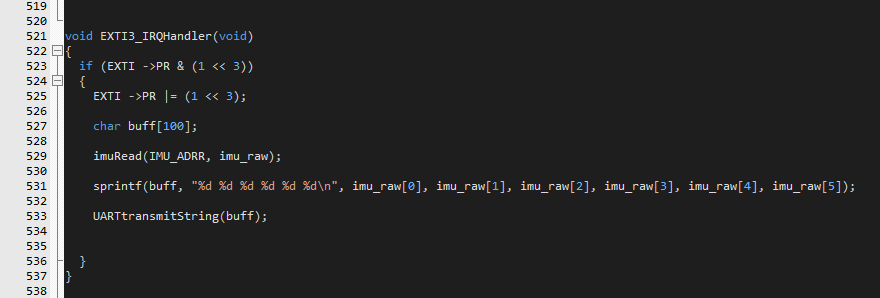

2021-10-15 11:22 AM
that is the handler implementation.
does it seem fine?
2021-10-15 12:12 PM
C++?
2021-10-15 12:15 PM
not sure what you mean but I am using C++
2021-10-15 12:23 PM
So it has C++ linkage, not C linkage, which means the linker doesn't see it as EXTI3_IRQHandler.
To fix, surround it in extern "C" braces.
extern "C" {
void EXTI3_IRQHandler() {
2021-10-15 12:25 PM
OK thanks.
the whole main file is cpp. does it still matter?
2021-10-15 12:28 PM
It works now! thank you very much
