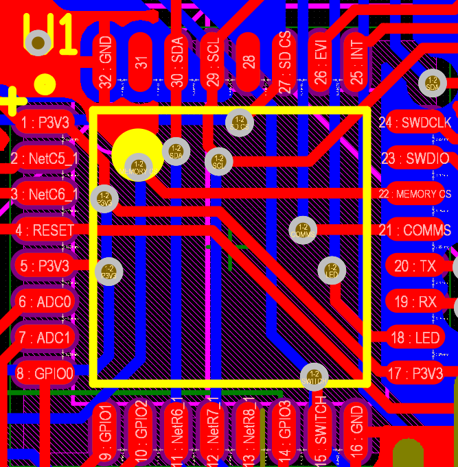

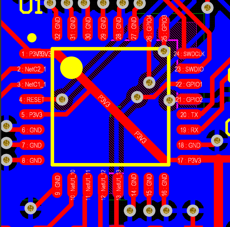

I have used this same chip on a previous project and managed to toggle an LED on and off using HAL_Delay(1000); function. I copied the same code across to my new project board, uploaded it successfully, toggled the LED on successfully but when I step into HAL_Delay(1000); it gets stuck infinitely.
I know it's a hardware problem because the same code works on my other board.
The thing that confuses me is the
What I'm asking for is there any places I should be looking for that might cause this problem on a hardware level, system clock problems?
Admittedly the MCUs are different batches, however I'm sure its just a layout problem.
This is the layout of the original board that works:
This is the layout of the board that isn't working:
2021-10-16 12:47 AM
Hi *****.4,
From your hardware layout, check pin 31 - it looks like that is the BOOT0 pin and should be pulled to GND. On the board that is not working, you have left it floating.
Hope this helps
2021-10-16 12:47 AM
Hi *****.4,
Hope this helps

Hi all, I wanted to just confirm that the problem was indeed hardware as I expected. As soon as I pulled the BOOT pin to ground (like pin 31 in the first photo was, but not the second), as per JVart.1's response there was no more issues with HAL_Delay, and everything runs as expected. (No code was just, just grounded the pin). Thanks all for your help!
