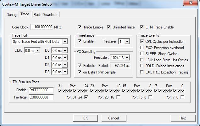

I'm using ULINKpro and Keil uVision 5.23.0.0 as debugger.
I can't make ETM Trace (sync mode, 4-bit data) works properly on a STM32F427ZG with a core clock of 168MHz.
I tried to lower the core clock working frequency to 42MHz, and that made Trace starts working. It's a problem of too high frequency?
Before this one, I tried to configure Trace on a STM32F407ZG, on the same board (pin-to-pin compatible) and with the same software (except for small mandatory fixes due to the different microcontroller). S
trangely
enough, this one works also at 168MHz, with the same Trace configuration!Here is the configuration screen:
This is the initialization file:

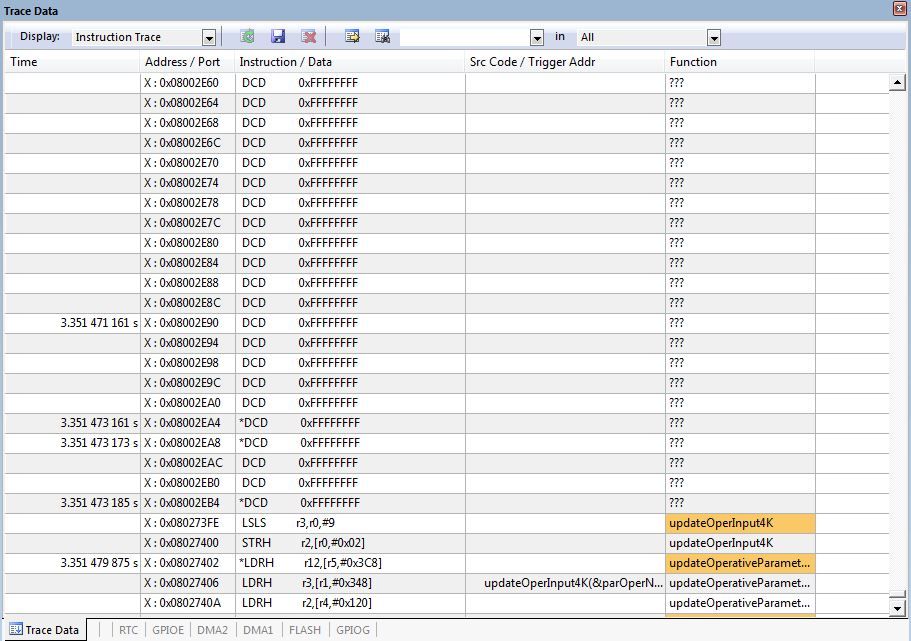

** Execute upon software RESET**-----------------------------------------------------------------*/FUNC void OnResetExec(void) { DebugSetup();}When I run the debug, Trace status is ''Data stream error''. When I stop the execution, there is an attempt to process the captured data, and after an
anomalous
long time I get something like this:Best regards.

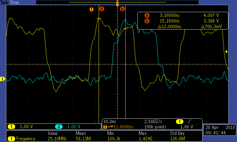

I've recently had a similar issues with the STM32F777II processor. I've compared it to the STM32F407 that is on the MCSB reference boards. Ended up having to add a 2.6ns delay on the Clock signal. Now the STM32F777II emits trace data at up to 216MHZ, and mostly synchronises well with the Keil uLinkPro in Keil MDK.
I had no issue with the Segger J-Trace in Ozone. It worked flawlessly at full speed without having to do anything.
I ended up scoping the CLK and TRACE_0 lines on a 300MHz scope with 500MHz probes. The behaviour is...odd. From the ETM timing specifications one would expect the clock to be delayed resulting in about a 90 degree phase shift between clock and data. However, tests show that the clock actually seems to precede the TRACE_0 data.
The yellow trace is the CLK signal, cyan is the TRACE_0 data signal. CPU frequency was 50MHz.
Unless the actual sampling occurs on the falling edge. Which is not what most ETM documents show.
The CLK and TRACE_0 lines differ with at most 2mm, which is negligible at the frequency of interest. Some clarification would be greatly appreciated.
